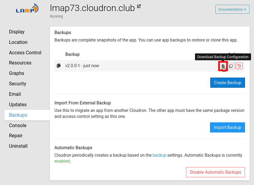

Backup existing app
The first step is to take a backup of the existing app. Then, click on Download Backup configuration to download the JSON file with the latest backup information.

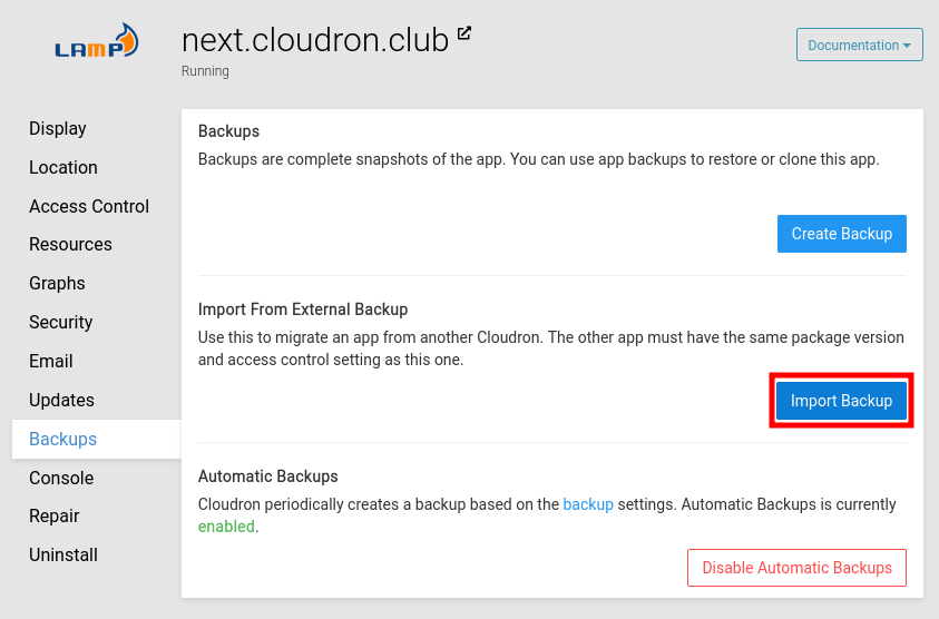

Install the latest version of the LAMP app from the App Store. You can install this in a new subdomain like next.domain.com. Once installed, go to Backups section of the app and click on Import.
This will open a popup dialog. Upload the backup configuration that we downloaded in the previous step.

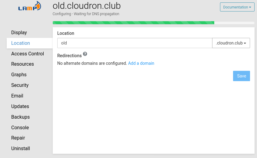

Once the app is satisfactorily running, it is time to relocate the new app to production. For this, first move the old app to a new location like old.domain.com from the Location section. Then, move the new app to the desired location.
We recommend keeping the old app for a couple of days before uninstalling it. For this, you can simply keep the old app stopped (Console -> Stop app). This way, if your app is mis-behaving with a newer PHP version, you can easily switch back.
