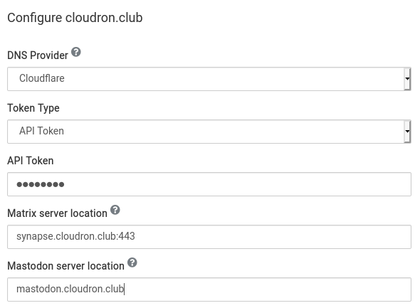

You can change the account domain name by using the File Manager and changing LOCAL_DOMAIN in /app/data/env.production. After that, you have to configure LOCAL_DOMAIN's web server to serve up .well-known/host-meta query.
If LOCAL_DOMAIN is an app on Cloudron, you can use Cloudron's Well Known URI support. Go to the Domains view and set the Mastodon domain in the Advanced settings:
